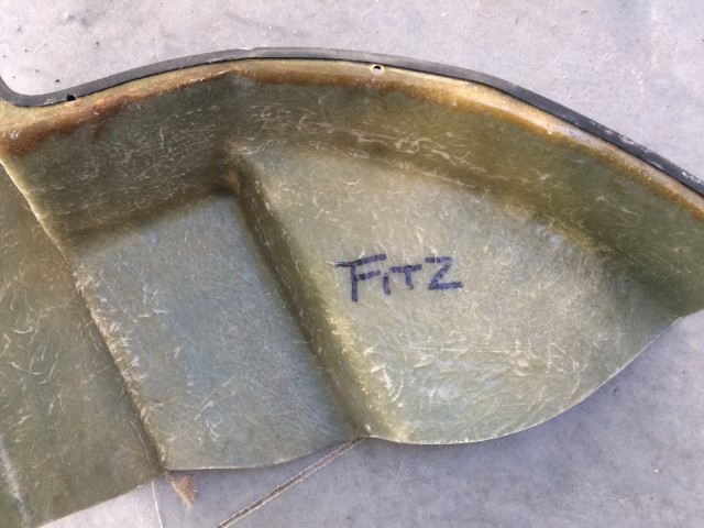

On different places I find a name ( I suppose ) of a person who has done the body grp , someone knew him ?
IMG_0187 (Small).JPG (82.36 KiB) Viewed 23735 times
The name on the panels is the surname of the original owner who ordered the car.

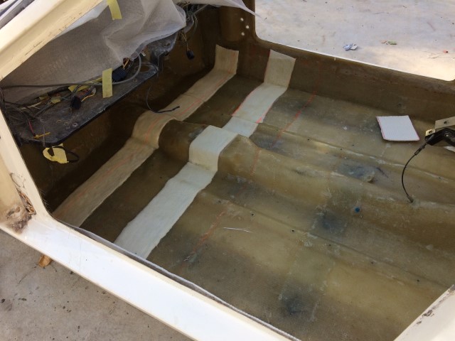

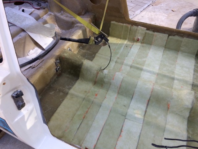

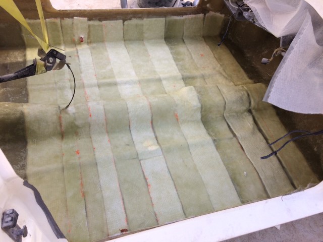

Today I have put some layers more for making the sandwish floor .
Feels much stronger than the original floor !
Next days I renforce the front and rear bulkhead , pictures follow !
