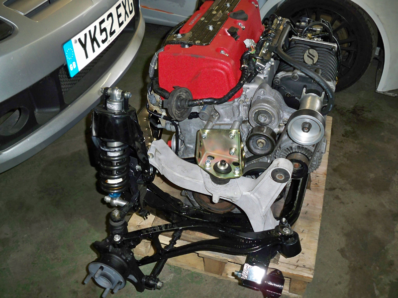

Re: AVONBAR
Talking of TF frames here's a nice Honda engine with 310 hp.
k-series honda in tf frame.jpg (463.55 KiB) Viewed 24393 times
Re: AVONBAR
Post by Jin »
Tasty :)

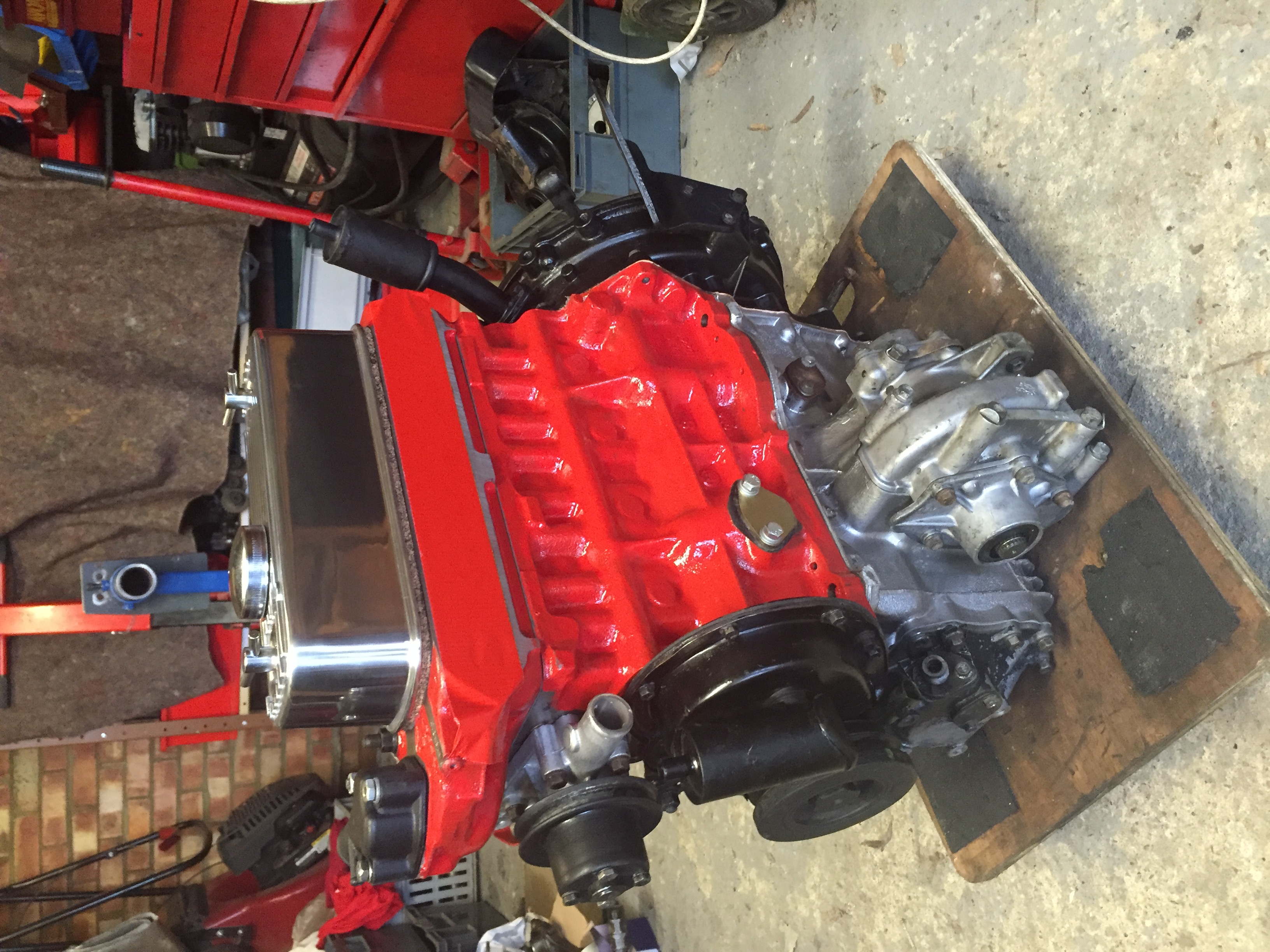

Post by axshack »
As I caused this thread to get off topic a bit - but nevertheless very useful information - I thought I would bring it back with photos of my now completed AVONBAR engine....very shiny and looking forward to plugging it into the car ASAP !
once again the pic is flipped !!

Re: AVONBAR
Post by axshack »
Jin wrote:Ooooooh
Shiny bits.
I love shiny bits
me too, and right now it is shiny inside as well as out !!
:D
Re: AVONBAR
Post by Jin »
Is that all dynoed up and ready to go?
Looks awesome
