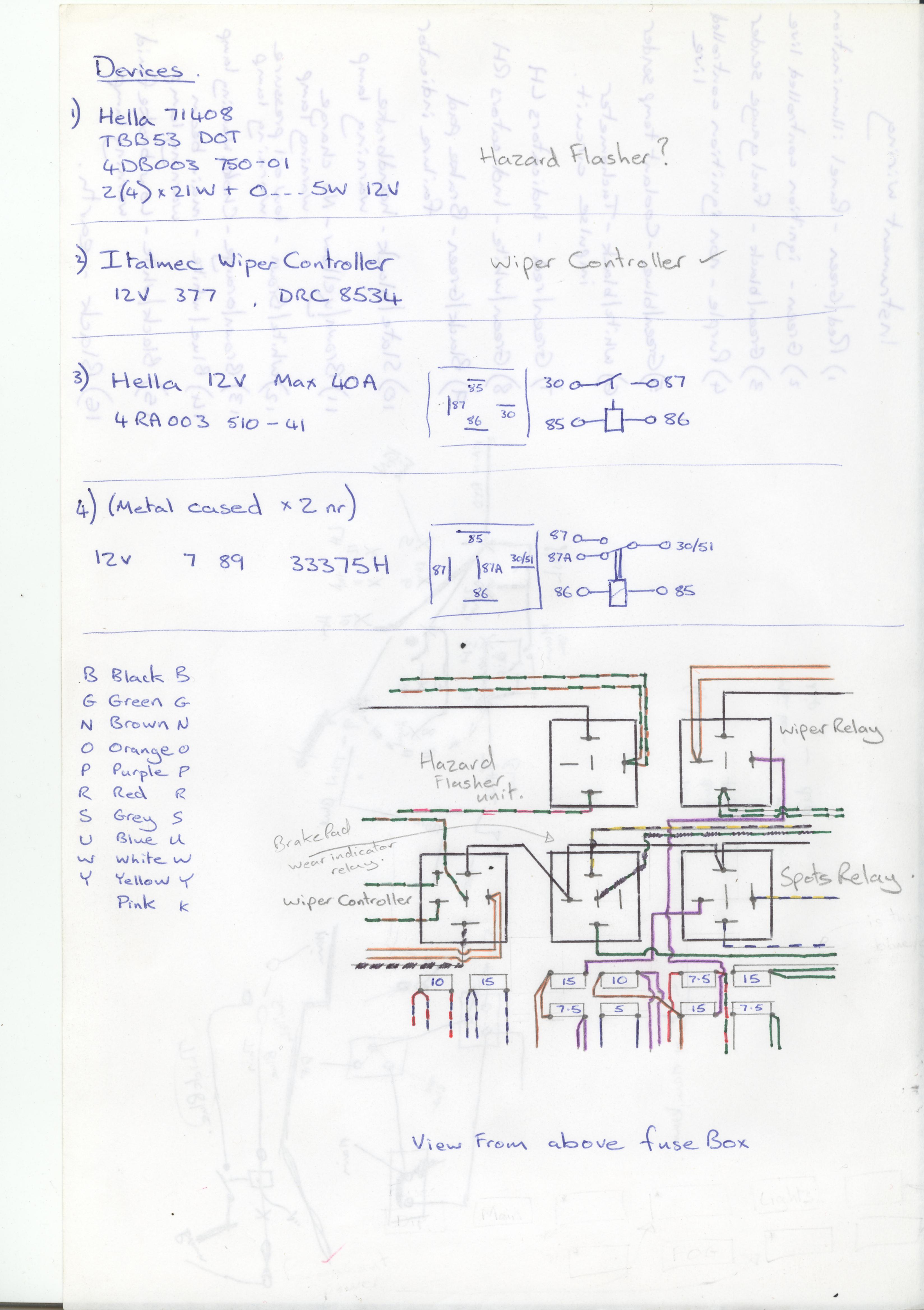

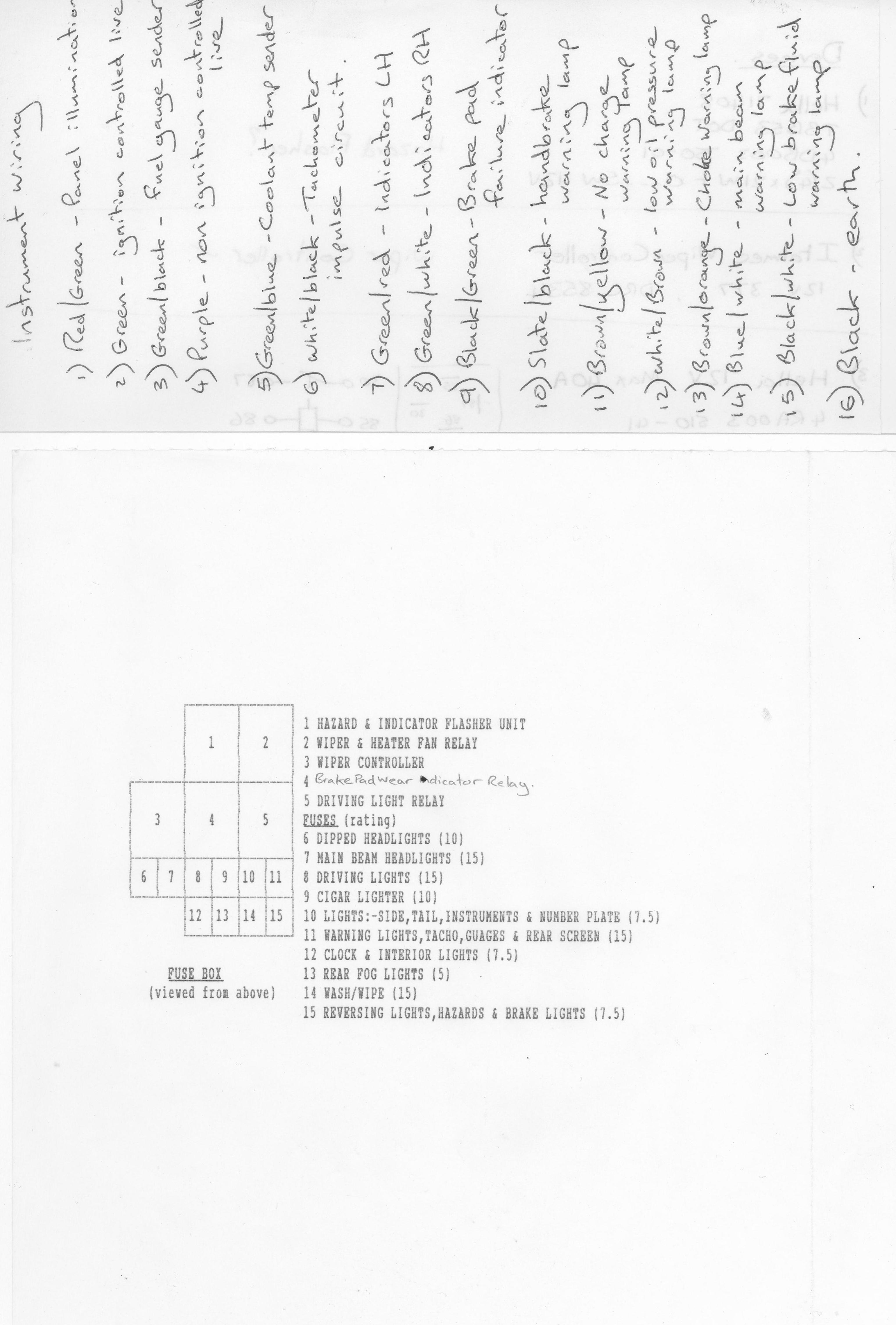

Yikes! no wonder my battery died. This is a huge power drain on a car that is switched off I think you would agree, so now to identify what is causing the problem. So I am going to pull the fuses one-by-one to identify which circuit is at fault...BUT...I cannot locate a layout of the fuse and relay panel that makes sense.
I assume I have an '84 MG Metro donor, but does anyone have a sketch or know where I can locate a diagram to identify the fuses?

When I looked at my 89 Gold Coupe fuses this was the layout, I don't know if yours is different (what year was your car hatched?).
The wiring loom in original Midas (Corby) cars was a Midas special, it was not from the donor vehicle.
Hope it helps
Regards Mark

thanks for that very useful I think. my car was hatched in 88. :)
