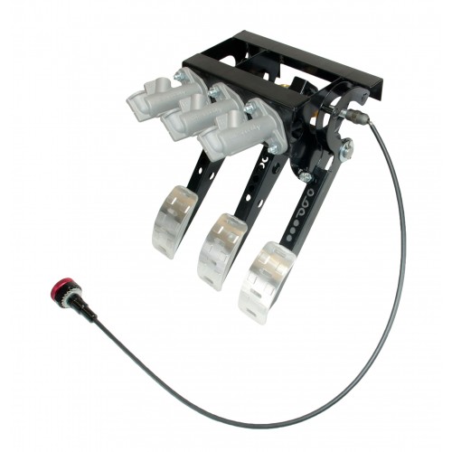

Can someone inform me if the pedalbox used in the MKII is an original Mini classic pedalbox .
The reason of my question is that I intend to install a assembled pedalbox mini classic with cylinders, biasregulation , etc.....
On the other hand, I do not want to cut in the polyester fibre ...just drilling some holes if necessary .
I just have taken a random example of such a box .
Thanks
pedalbox  OBP
