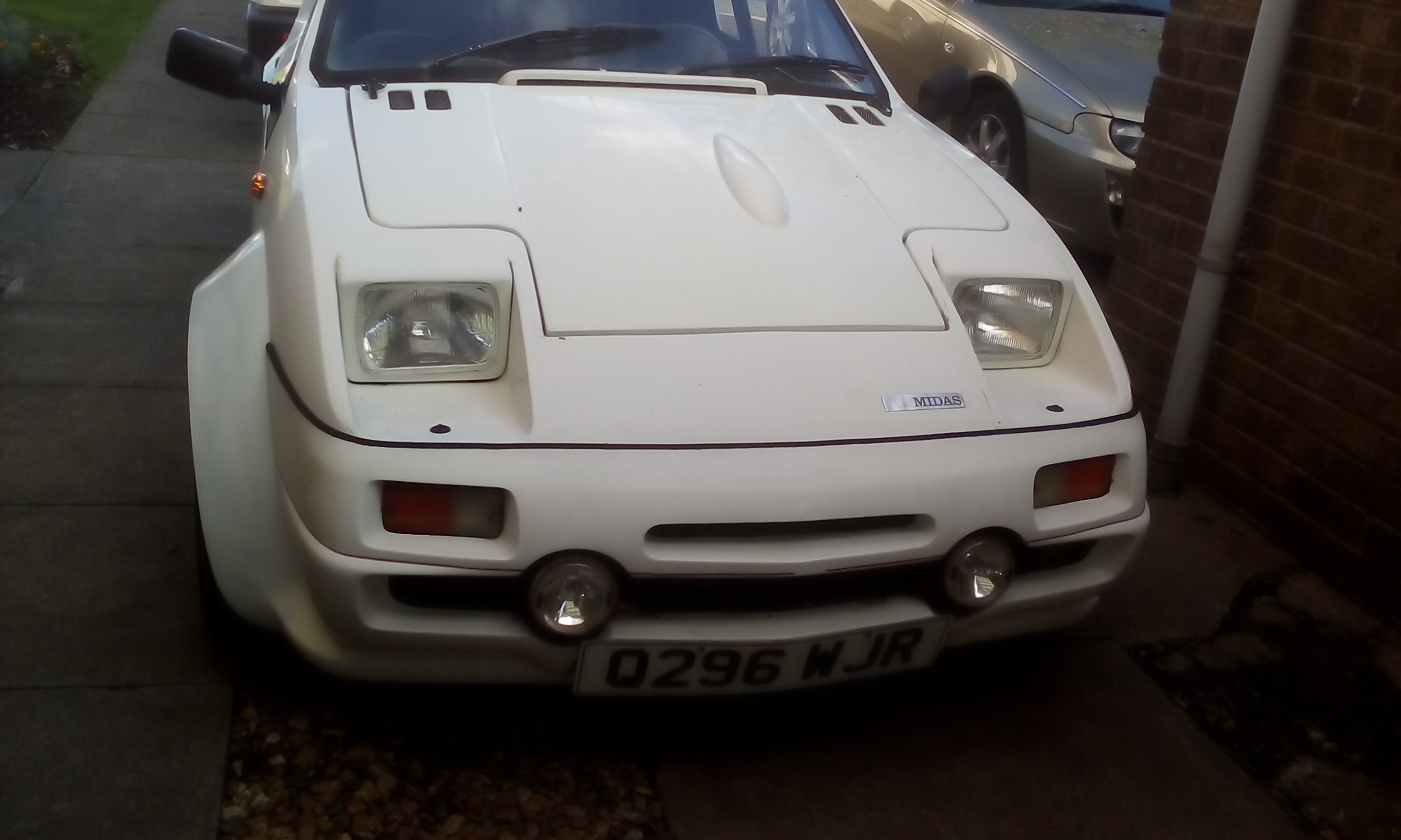

Looking for headlights for a 78 Midas. And info greatly appreciated

A 78 Midas, that's interesting. Chassis numbers 0,1 and 2 were 1st registered in September, October and November 1979.
What chassis number is yours?
Re: Headlights
I'm guessing that your Midas has an age related plate from the donor Mini, hence 1978.
Your car would therefore be a Mk1, or Mk2 and use Austin Allegro/ Triumph Dolomite/ Hillman Hunter type head lights. These have been appearing quite regularly on ebay as new/old stock.
If you don't see any when you first search then 'save the search' and you will get new items emailled through to you when they appear.
The Metro headlights use the same lens and body, but the mounting tabs are different and not easily modified.

okI fitted mini van headlights and backplates tight fit much beter lights ebay new old stock

SMACK wrote:] okI fitted mini van headlights and backplates tight fit much beter lights ebay new old stock
Here's what I see when someone says mini van Image

Hi my mistake headlights fitted to my midas boughtalong time ago fitted last year rover metro 3and 5door hatch85 to90 steel back plates and fiber glass had to be cut ipaid 50 on ebay now 50 each i think this is the right model quite awkwardto fitbut worth wile original lights are very rare metros are easy check sizes before buying slightly larger trim needs cut
