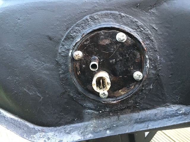

Despite my best efforts, and expense, the resurrection of my old tank has failed! I have cleaned and painted the outside and sealed the interior (which was remarkable rust free considering its age).
But, the reason I did all this - the non-functioning fuel sender unit has proven to be the worst problem. It stopped working because the rust on the locking ring became too advanced and there was a loss of electrical integrity! Still, Nil Desperandum I thought. I confirmed the sender was still working and attempted to replace it. However, the rusty locking ring started to disintegrate on reassembly and would not seal properly. I tried to help it out with some self-tapping screws to hold it in place, but, it leaks like the proverbial.
So, after two weeks of effort and wasted money I give up - the tank is headed for the scrap yard. I am going to have a bespoke aluminium tank made ASAP (because replacement Metro tanks are non-existent as far as I can see). I will continue to use Ethanol free unleaded (BP Ultimate) so I am hoping that any incompatibility between aluminium and ethanol will be minimised.
This is what I intended to do right at the start but was persuaded to try and refurb the original....I wish I had followed my original plan now :|
Attached is a photo of the sender unit in place for interest.

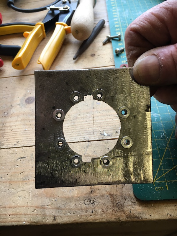

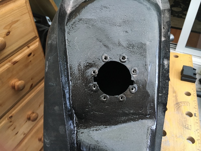

To that end, I have chopped out the old Sender unit mounting and made a new one, which my mate welded in for me.
Next, I am going to do a leak test and am hopeful that all will be well because the amount of mounting screws (instead of the old locking ring) should be enough to hold it all together (see photo).
I will keep you posted!
replacement sender unit mounting
old sender unit mount removed

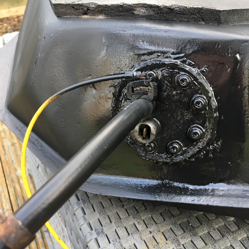

new sender mounting welded and painted .....
IMG_0664 2.JPG (156.47 KiB) Viewed 15257 times
Re: FUEL TANK
Post by axshack »
Final photo of repaired fuel sender unit mounting....still wet from paint. Looks a bit messy due to the thick cork gasket, but so long as it is functional, who cares?
Leak check: OK
Electrical continuity: OK
Going back on the car tomorrow !! :P
