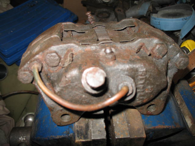

Nice one Chris. This is another option drilling and tapping out the bleed nipple to make a link pipe and then use a hose with a single banjo fitting.
Picture 240.jpg (57.37 KiB) Viewed 15235 times

Interestin idea, but, as I need to buy a complete set of braided brake hoses (the front ones on my Mk2 were more than old, and the rear braided hoses were twisted !), I don't feel enough confident to take the risk to drill my calipers incorrectly.
