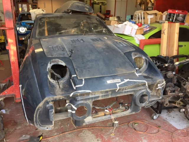

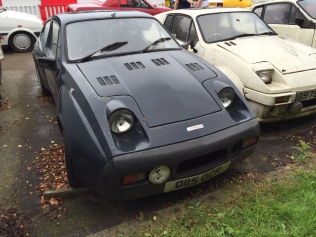

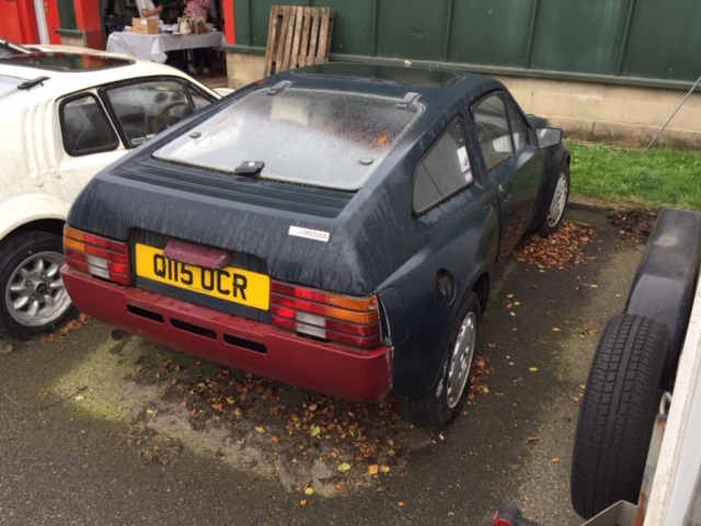

Once the car was dismantled Alistair and I identified the work that needed to be done before repainting the car could start.
This is the car at the start.
Identifying bodywork problems.

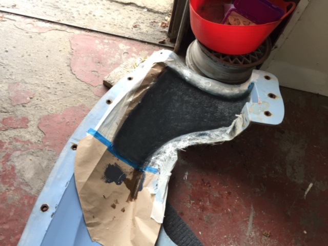

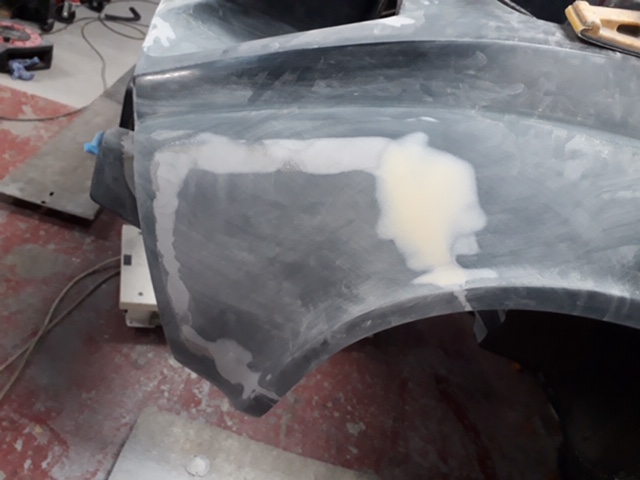

Part 2.

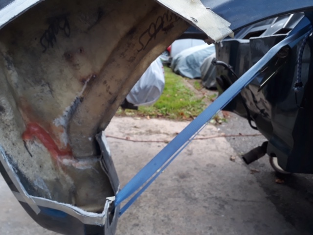

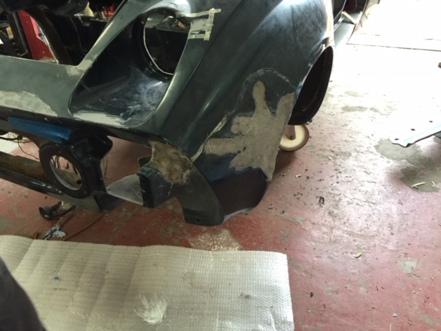

The main problem was damage to the front nearside which in the end needed a new section fabricated. Once the damage was cut out Alistair noticed that there was also damage to the internal structure of the engine bay that need repairing before the new section could be grafted in.
Joint before laminating..JPG (90.58 KiB) Viewed 34098 times

Part 3.
New section grafted in. Alistair did a great job!

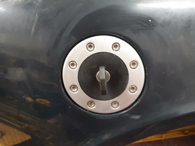

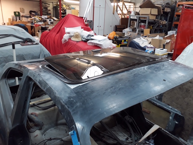

After the repairs where all completed there were a few jobs that needed to be done before sending car off to be painted like altering the aperture for the mgf filler cap and also enlarging the hole for the new sunroof that will be fitted.

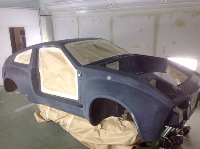

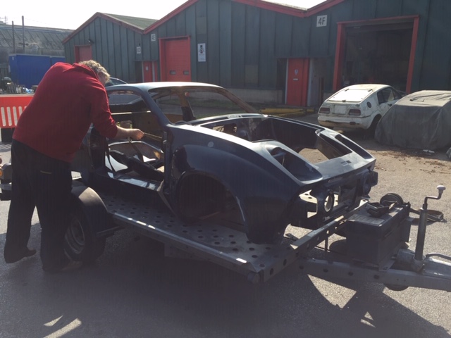

Part 4.
After a long but necessary wait moving day finally came and we loaded the car onto Alistair’s trailer for the short journey to the Paint shop.
The first stage was flating the whole car for the first primer coat.

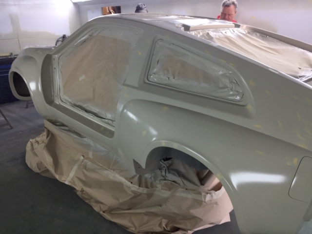

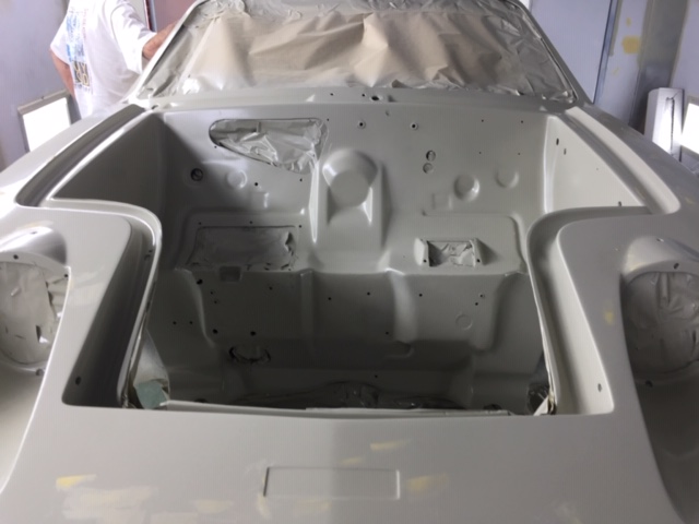

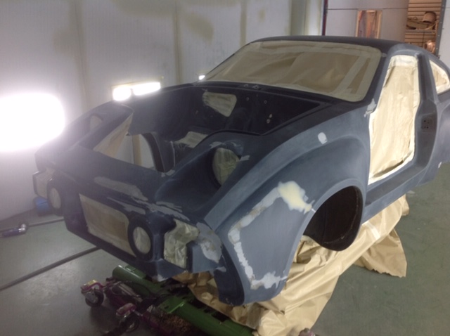

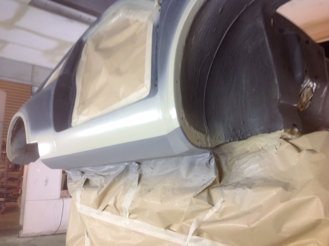

Part. 5
Then stone chip was added for that extra bit of protection.
Followed by primer and then final filling of all those tiny imperfections.

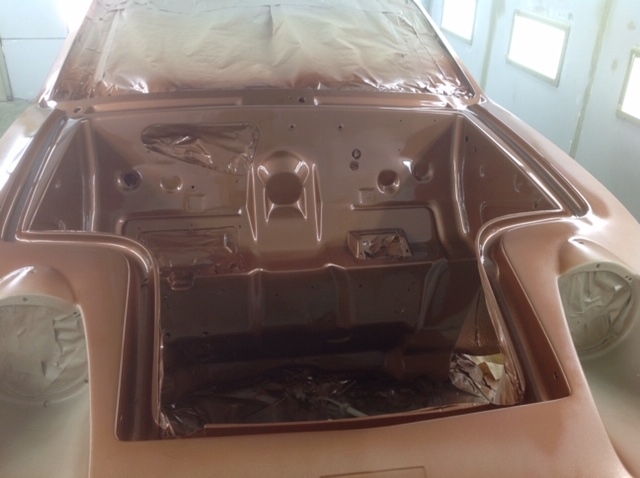

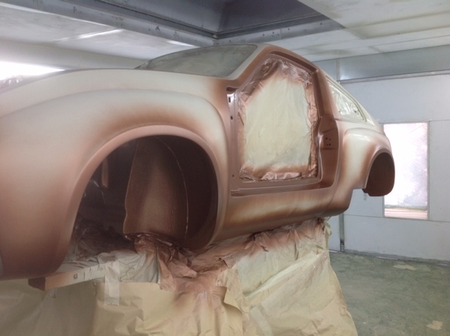

Part 6.

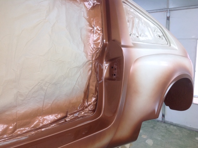

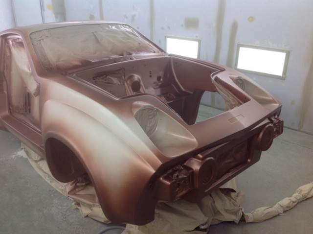

Sorry folk for the delay things got a bit busy. So here it is the first few shots of the door shuts.
These photo are of the base colour coat without lacquer.

Part 7.
And now with some lacquer.
For those who are interested the colour is a Ford colour used mainly on the Fiesta range but I have seen it on others and it’s called Copper Pulse.
I have more photos of the process but I’m going to see the next stage at the weekend when hopefully the whole car will be almost completed. So I’ll be back soon with another update.
