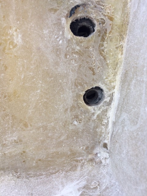

Hi , does someone know the exact diameter of the tower holes in the grp ?
Re: Rear frame MKII

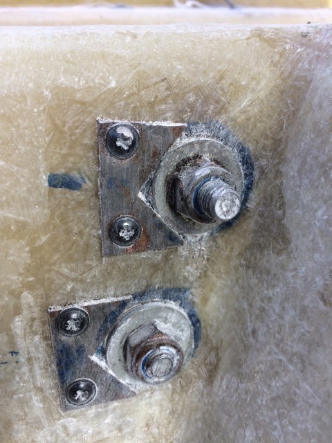

Hi Stuart
In annex you can see what I mean what Brian did to fix the rear frame at a certain position .
The place of the system to fix the bolts are just near the middle tunnel , right side , seen from the back of the car .
And you are right ,Brian did change the position of his rear frame some mm ( +- 6 mm) to the left , also seen from the back of the car .

On my own Mk2, the bolts, who seems originals, are 3/8.
